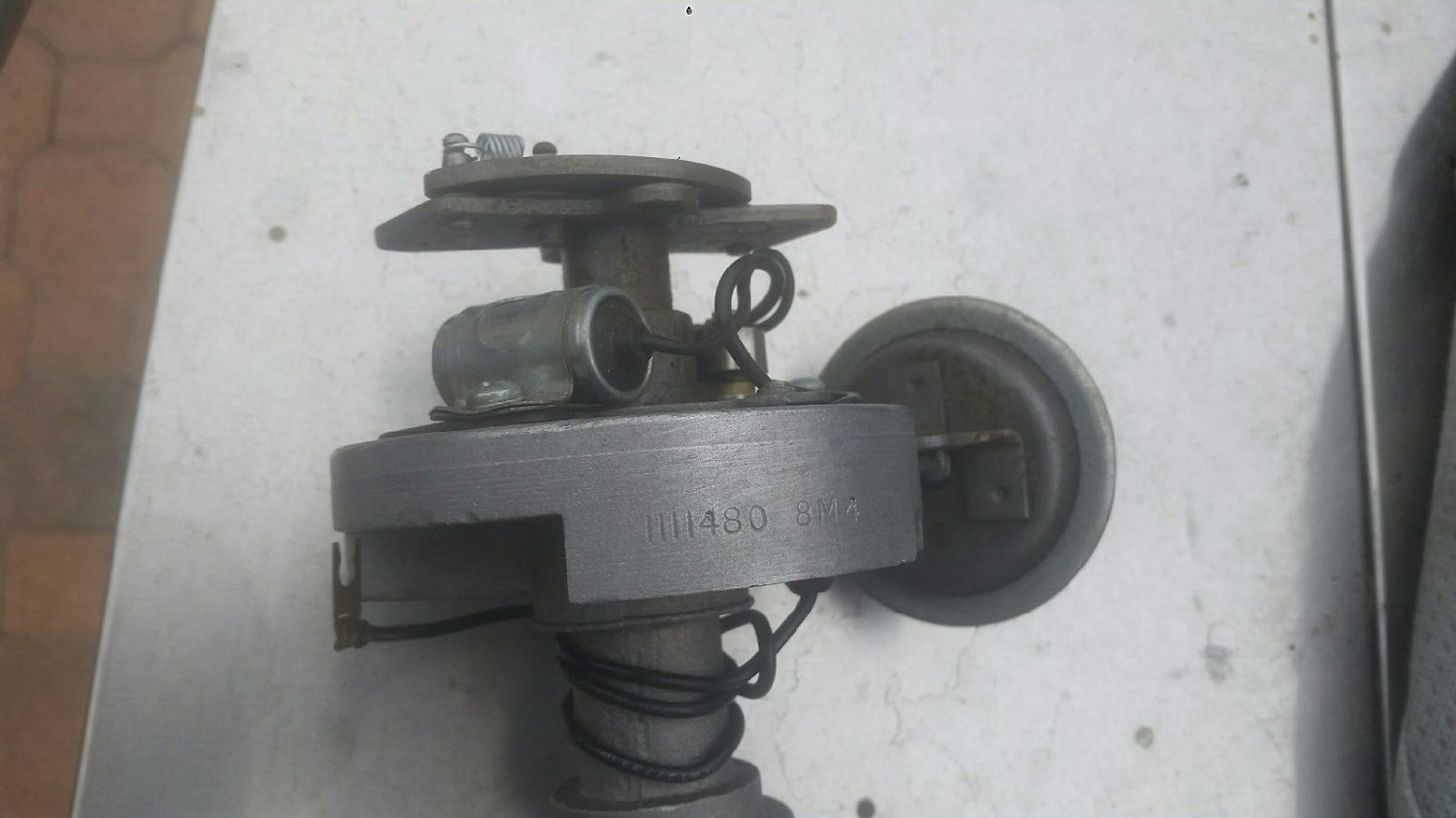

Just making sure it real. Been in garage for years and was rebuilt and stored. What's the value of this? Thanks

Default Larger Picture
Close up

it does not look real to me

Hard to tell from the pic, kinda grainy. It looks to have been sanded down, some of the machine marks are gone. Check the advance plate and post a pic of it. I’m reserving judgement.

Another pic

Pic again

My opinion is the same as Little Tommy's. Hope you aren't too deep in it.

fake

restamp the 4 is wrong

4 8 and 0 are wrong
