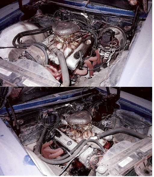

hi
what are the 2 correct decals i see on the deuce top radiator bracket
mine has one on the driver side "emissions control CT decal"
but what is the other suppose to be
and pictures
please
thank you
chris

would they be the same as a 1970 Z/28?

Should be a coolant protection decal. Protected up to -20 on the pass. side of the top radiator hold down or bracket and the emissions decal on the driver side.

The coolant sticker only came on export cars to Canada according to crg

so i have seen restored deuces with 2 decal one pass and one driver side
so do i put both on to be correct....or not???
need a deuce guru ...as i am unsure
regards
chris
1970 citrus Yenko Nova
Incorrect!! Chris, I would put both of those decals on...

Crg confirms the Camaro only came with the one, are you saying the Nova is different?

If it is not in the assy manual, good chance it did not happen.

I have seen some old Hot Rod articles with pics showing those two decals on the radiator upper cover of Camaros. My 72 Nova is a all original car and has both decals. I don't know what to tell you, maybe some cars came with both decals and some didn't. I have seen my share of Novas over the years that had both decals. Maybe it depended on what part of the country the car was shipped too?? The assy. manual for Novas does show both decals...
