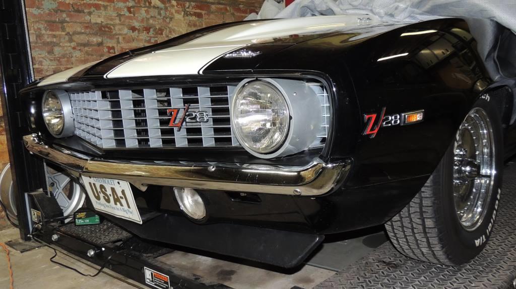

Pics of the two cars attached. On mine, one is with flash, and one without. The flash shot makes it look almost too light, but I am very happy with the color. I think Rick's looks way better with a silver grill.

Couple of before shots.

I knew the color was right on, as I had a very old pair of NOS headlight bezels in silver. I didn't feel like stripping the paint off the ones that were on there.
