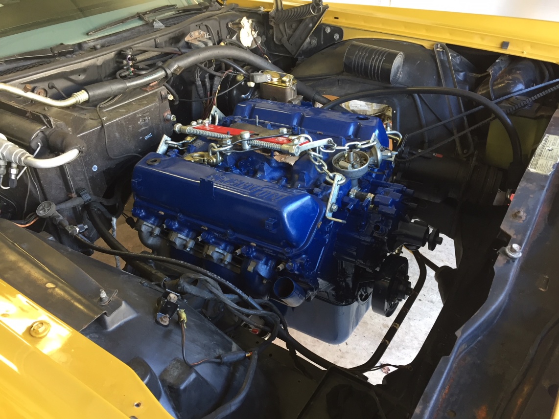

Thanks. It's fun to challenge yourself once in a while with something completely out of one's automotive comfort zone. I never worked on a Ford before. It seems that a 460 Ford is just a blue-painted, big block Chevy with the distributor at the wrong end. Look at the valve cover bolt pattern and the way the staggered valves are laid out.

And the cylinders are numbered wrong.

Naw, the engine is just backwards.
Look at where the sump is in the oil pan, combine that with the distributor location and it's a backwards 454.

Plopped the old 460 into place this afternoon. Rather uneventful when you don't have the transmission attached. It took, at the most, twenty minutes. I did have the take the wheels off and lower the nose down so the engine would fit over the front header panel without the hoist hitting the garage door.
After it was in place I used a floor jack to support the back of the block til I get the transmission installed tomorrow or Monday. I borrowed my buddy's truck jackstands so I can get the transmission and trans jack under the car.

More stuff going on. Got the original date coded alternator and smog pump back on. Jeez - these Fords have everything bolted to everything else with individual belts for everything, as well. That monster 460 engine looks tiny in that enormous engine compartment, doesn't it? Looks like a 289 in a Mustang engine bay. At least there's room to work!
