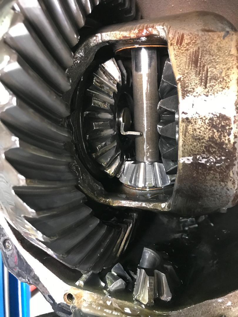

Jason, let me know if you need any help with that. Tom's Differentials had special heat treated 17-10 gears once. I don't know if they still have them or not. It's been a few years since I got any from them. Looks like it still had the old bronze washers in it. The steel washers are stronger. You are going to need a set of springs and plates too. If you want to take it out and send it to me I can fix it and send it back. Did you inspect the ring & pinion gears?
