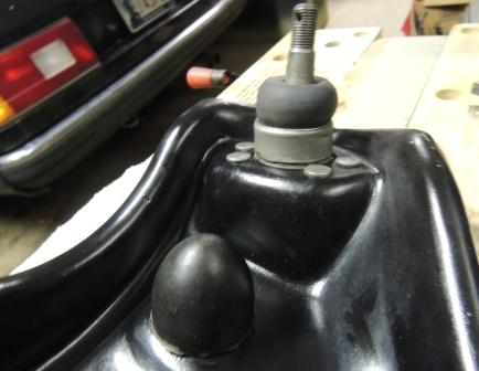

Anyone know a good source for riveting button style with the flat? Bair cannot do these. Shown is a '70 camaro. Do any other models share the same type?

I had a close friend do mine and he milled a flat onto standard ball joint round head rivets.

Those are super nice. Is your source open to do others? I have the arms and spot-welded ball joints.
