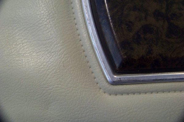

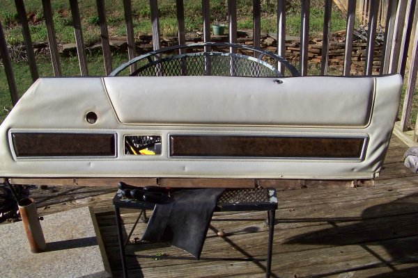

I used goof off to remove black vinyl dye from Neutral - (off white) colored door panels, It took nearly half a gallon to do 2 door panels... I used a 2" wide chip brush and a dish, brushed it on and used an old hand towel to wipe off, (paper towels do not have enough tooth) kept going until I made a dent and then used a tooth brush to get into the detail areas.
I bent the tooth brush to a 75-80 deg angle right at the neck then take a pair of sharp snips and take a few light snips out of the bristle face - (makes them uneven so the longer ones work into the recesses and the shorter ones stay on the upper surfaces) and then work slowly clock wise and then counter clock wise with enough pressure that the bristle tips do not roll over-
