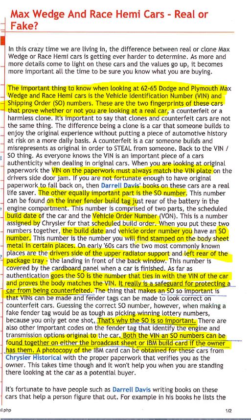

The IBM card contains the Shipping Order (SO) number and the VIN number. According to the attached article from Maxwedge.com “the SO is the number that ties in with the VIN of the car and proves the body matches the VIN. It really is a safeguard for protecting a car from being counterfeited.”

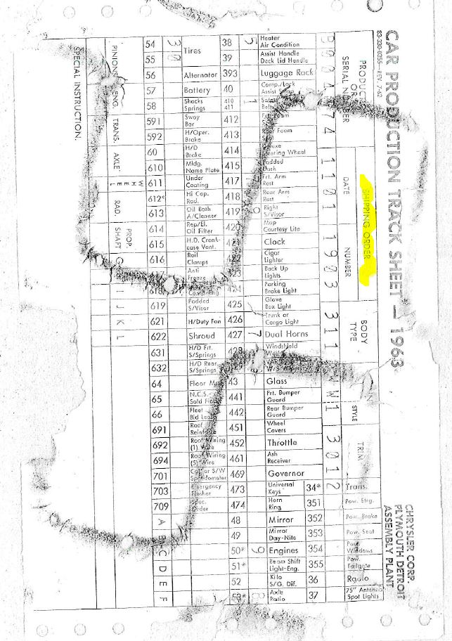

I have also attached a copy of the original “Build Sheet” for this vehicle. The shipping order number on the build sheet, taken from the car, matches the SO number. There is no doubt that this max wedge car has its original body and Sheetmetal and that the VIN number on the car is the correct matching VIN number for the car.

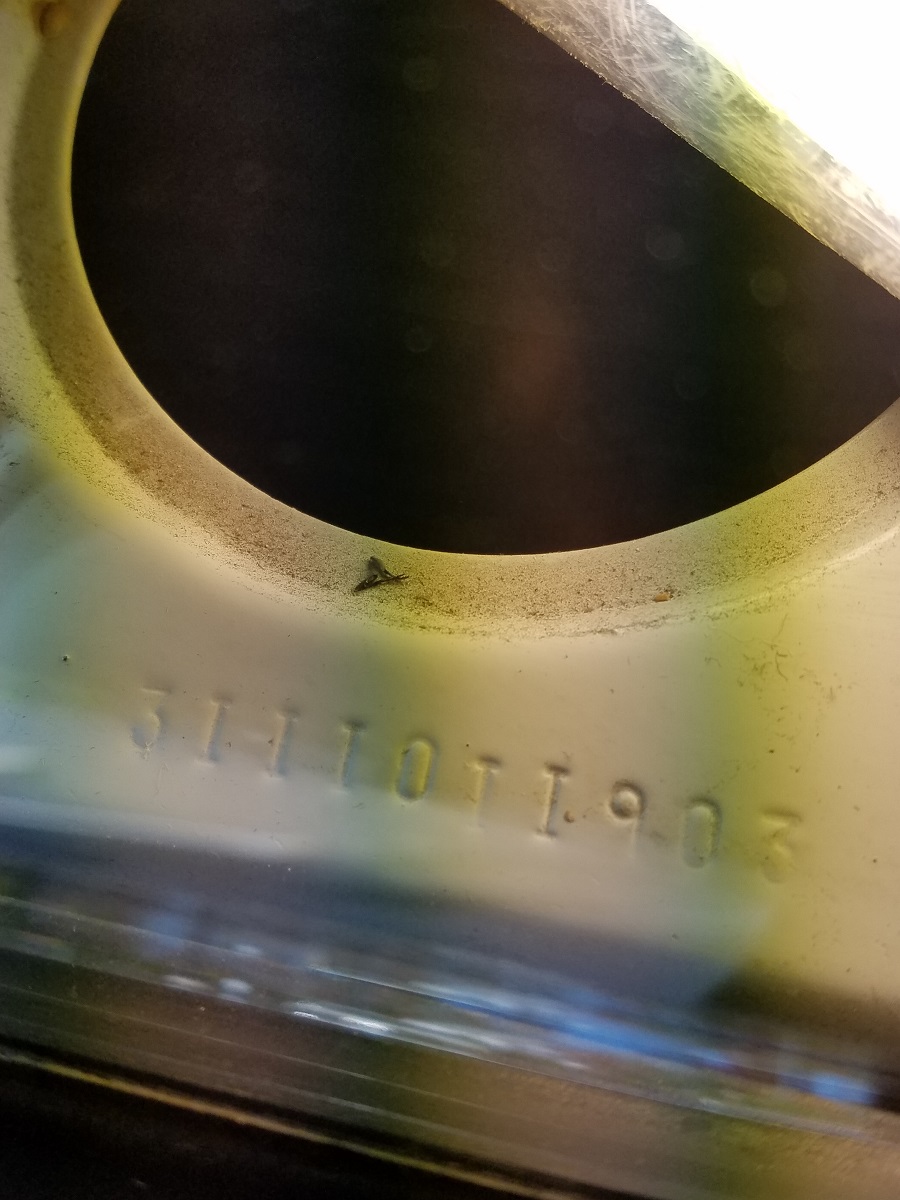

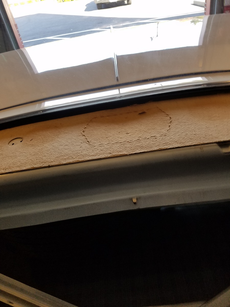

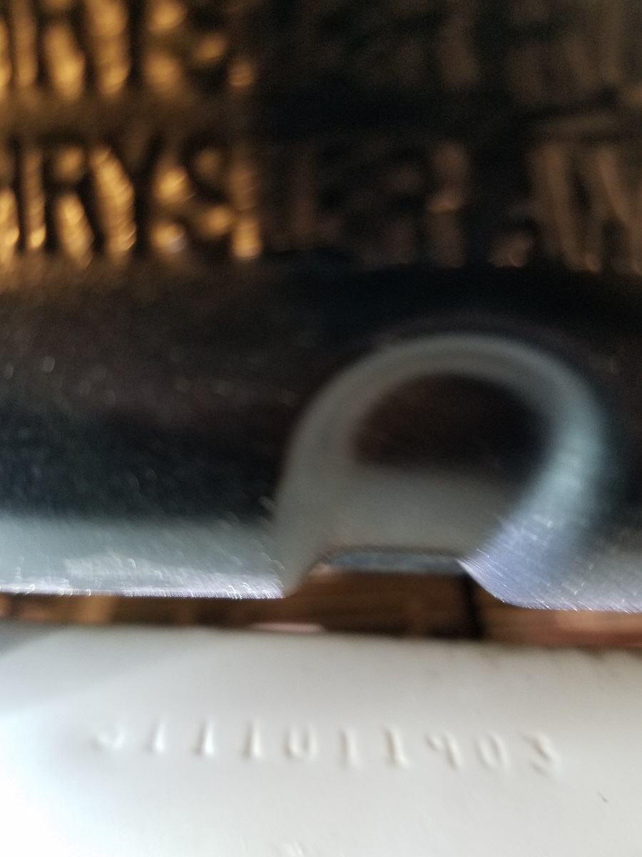

I have attached photographs of the SO number stamped into the front radiator support as well as the SO numbers stamped into the rear package tray, in front of the rear window. I removed the rear seat, cardboard backing, tray cardboard and finished panel in order to take photographs of the SO number (photo’s attached). I will leave the rear seat assembled so that you may come to my shop to verify these numbers. If I don’t hear back within a week that you would like to document the SO numbers on the car then I will put it all back together.

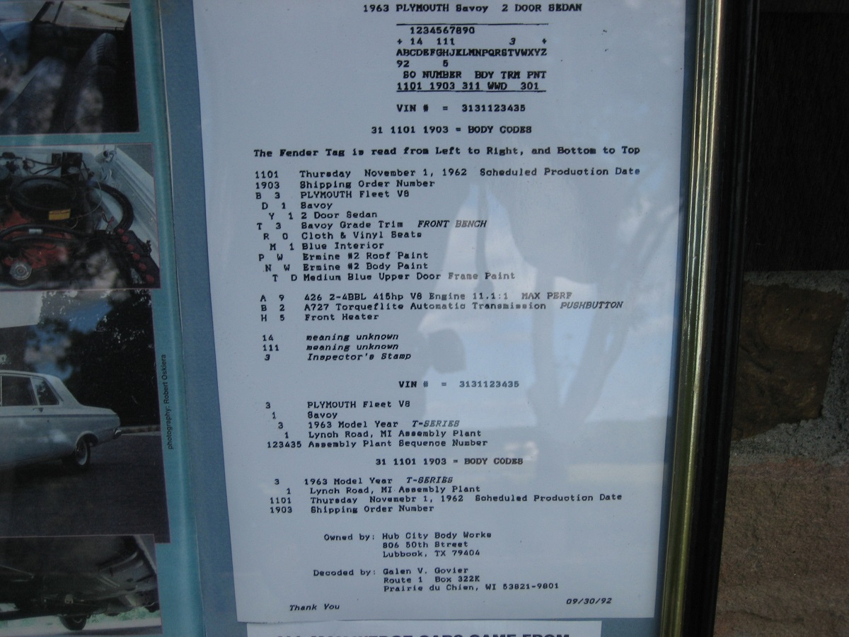

Although someone has questioned the crudely attached VIN as being authentic because of the small font, raised numeral stamping, I have attached a copy of another small font, stamped VIN from a “REAL” Max Wedge 1963 Plymouth Savoy (built 12/62). Although the VIN has been removed from the car (during a restoration) it is the real original VIN. So it is evident that the early 63 Savoy’s (mine was built 11/62) had this type of VIN tag. I will really need to look at some other documented early 63 Savoy’s to see if their tags appear differently.
Although you sent me photographs of two additional MOPAR VIN’s, which appear at the end of this e-mail chain, neither is a VIN off of an early production 1963 Savoy Max Wedge Car. One is from a 1964 Plymouth Savoy (3141) and the other is from a 1962 Plymouth Savoy Suburban (2521) six cylinder car. The “pre-punched” type of VIN tag may well have been only for the standard Savoy’s (punched 31 indicates Savoy) and the special production Max Wedge cars received the “stamped” type. Regardless of what was used back in the day this 63 Max Wedge is a real Max Wedge with all matching body numbers.

The WEBSITE used as a reference for this is >> http://racehemi.maxwedge.com/topics/real.php
