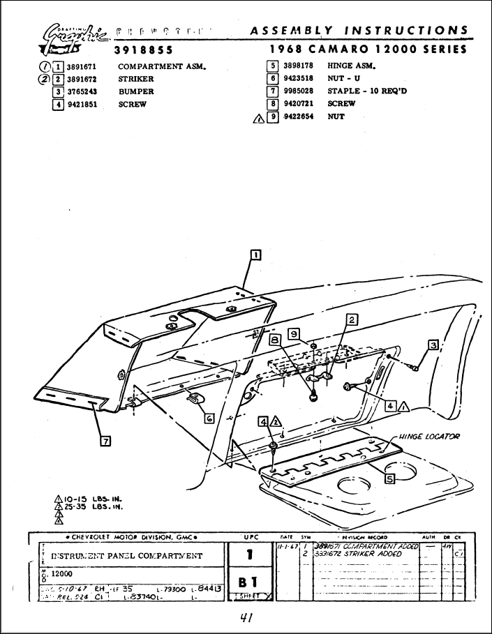

Regarding the glove box I am installing also from Classic Industries. Please see the attached pic from the assembly manual. I don't see any brace or support to keep the glove box horizontal. Does the box remain secured enough with just the screws that screw into the glove box door frame?
Thanks in advance. Jar Head Jim

Just the screws hold it does not have a brace. My conv top does not go all the way down either have to let the boot sit in the sun for a while to get it clipped
