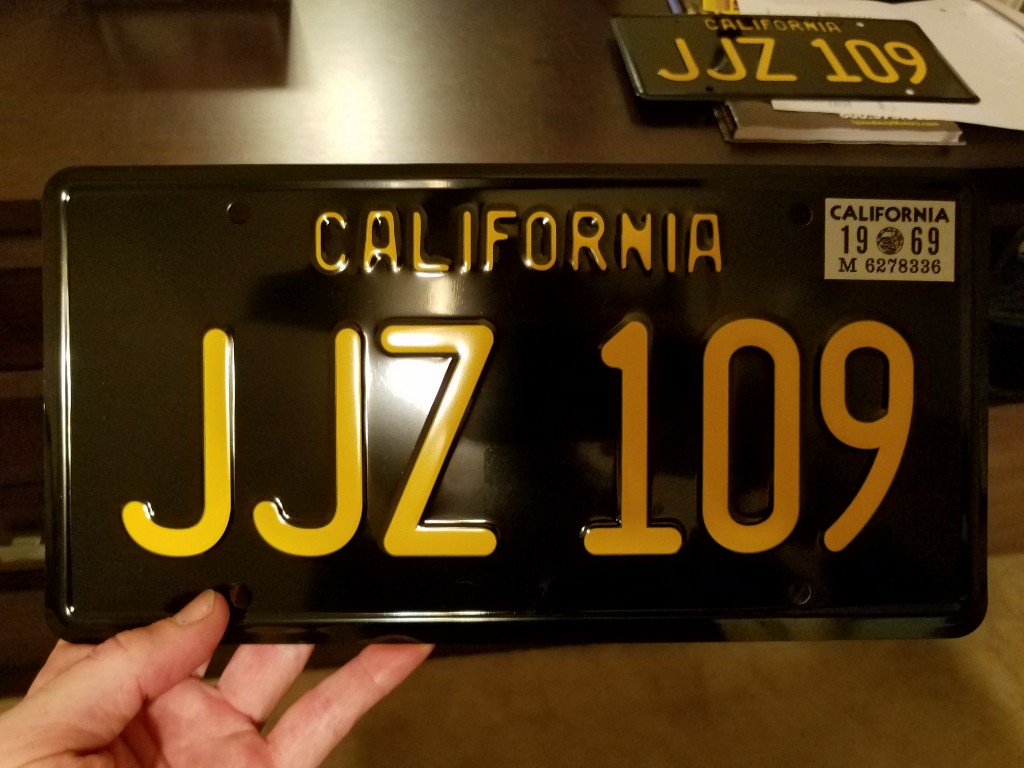

Oh.... and since I'm shipping the car back to Ohio, instead of the fresh Bullitt plates... maybe I need to restore the plates that came with the car?
