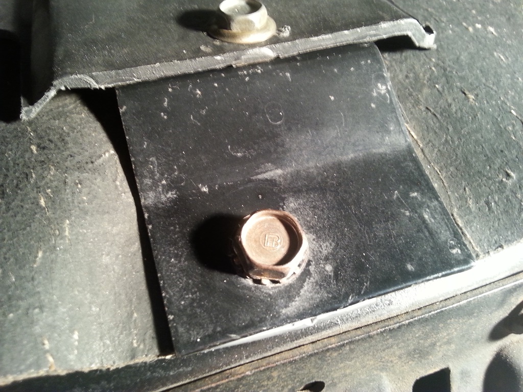

I'm looking for verification of the correct bolts used to mount the front of the fenders to the Radiator Support, the grill to hood latch, hood latch, and the hood latch striker. Are these bolts the 12 point bolt with flat washer? Are they the 6 point hex with flat washer? Or are they the 6 point hex bolt with built in type of fixed washer on the head of the bolt? I've seen 68's and early 69 Nova's with the 12 point bolts and I've seen some of the mid to late production 69 Nova's and the 70-up Nova's using the fixed washer to the head type of bolts. Here's pics of what I have now. This car is built 05C, 3rd week of May. Just looking for verification of the correct bolts. Thanks everyone!

The bolts you have pics of, look to be correct. They look the same as what i have on my unrestored 70. I would leave what you have alone. Maybe Sammy will chime in. He has a very nice unrestored 69 Nova.

Yeah I agree. After checking out the assembly manual, comparing part numbers, cross referencing, and coming up with identification photos, Everything I have on my car is correct. The majority of these bolts are 5/16-18 bolts, but some are fixed washers, some are separate washers, some have pointed ends for self aligning, and some have flat threaded ends. I believe Ive got everything figured out and what Ive shown is what I'm going with. Thanks guys! I appreciate everyones input and support! Thanks sYc and members!
