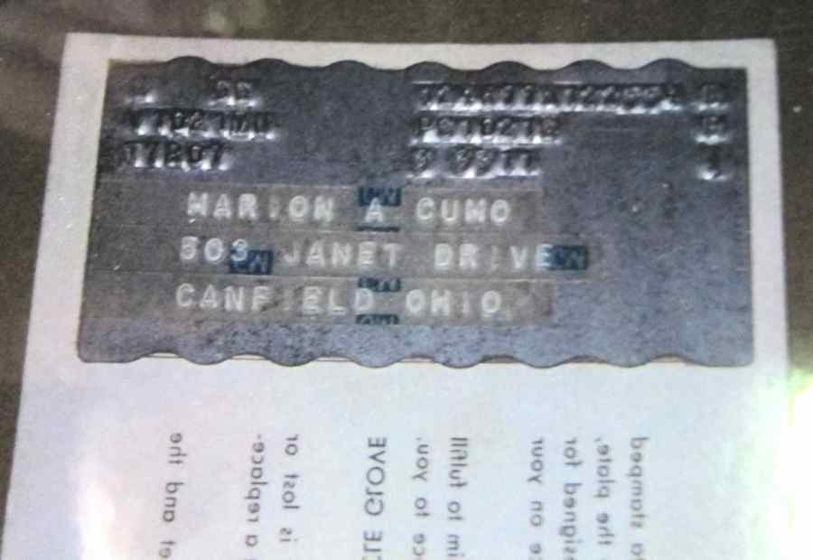

Lightbulb 67 Brass Hat Camaro for VP? Ordered w/ Firebird Int?
http://www.sgccars.com/1967-camaro-brass-hat.html
Nice history if true.

I’d like to see the pop and see what is the engine code.

It is not a 327 car. Engine code on POP said V1021MU. Here is the cowl tag from the 2015 MCACN show. 4P code with auto means its an SS.

The MU code on the POP designates that this car was originally equipped with a 350 ci 295hp L48. The unique feature for the SS Camaro was the 350 ci engine, because it was the first Chevrolet to get this engine. I guess anything could happen, but I'm not buying 327ci SS Camaros.

Def has some "oddball" things about it. The fenders have 327, SS and some other holes where there was some other emblems on it. If nothing was added, that in itself seems like an oddity, ie the 327 and SS emblems.
Wonder what the holes next to the SS was for?
Def has firebird interior, which is strange as well again if original.
