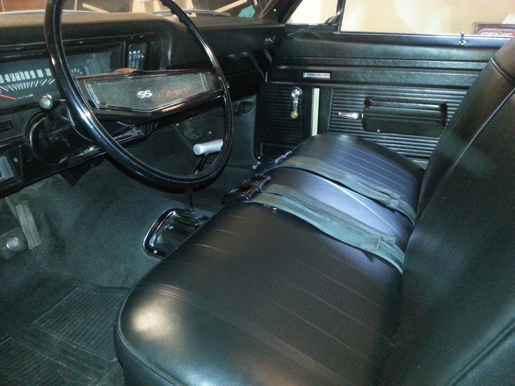

Sweet Nova you have, very nice. Love the rubber floor bench seat look...
