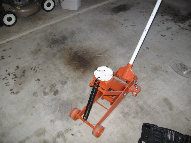

Originally Posted by bluel78 View Post
That's a good idea to keep the springs spread, how do you install the spring without damaging the new plating?
Dustin
Not my spring in this photo but I did the same thing.
Stretch spring on your Hydraulic jack then add a bunch of shims in between.
Should pop right in with hood all the way up, then close hood 3/4 down and some shims will just fall out or you can pull them out by hand as the tension is gone.

That's a good idea.... I wouldn't stretch it that far. I would use paint stick instead of shims those could chip the paint.

I saw the floor jack trick on a U-tube video. Also, someone used a Port-a-power to spread the springs to get them off the hinges. Hinges were off the car like mine are, so I can't use the hood to stretch them.
I don't think I'll do that near the car though, just in case I create a missile.
Verne
I agree, Popsicle sticks will work too.
