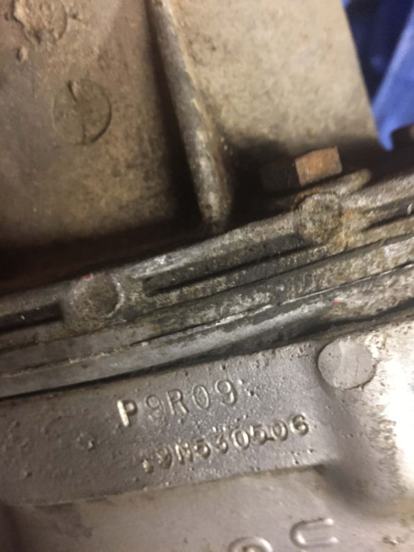

The fonts in the engine vin and trans vin are totally different look at the 3 and 9

I was looking @ that too...Look @ the O's & 0's too.

That engine stamp looks really bad to me, but that trans stamp looks good for the early font style Norwood used . FWIW.

I personally think the engine is a restamp (especially the vin) and trans is legit.

The stamps are fine, IMO.
