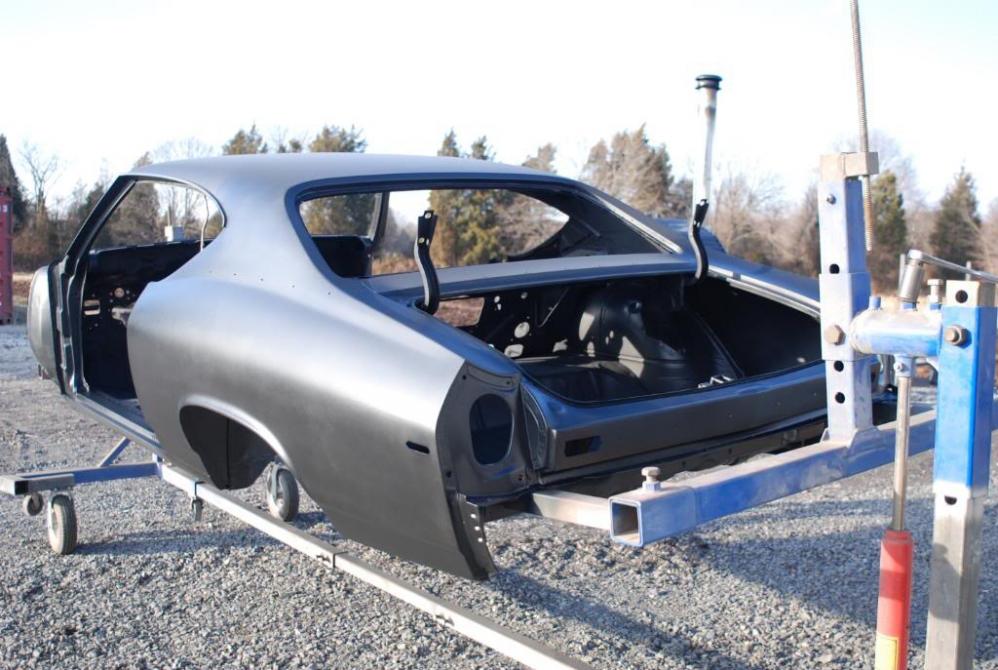

  #2208
Old 03-12-2017, 11:40 PM
Ryan1969Chevelle's Avatar
Join Date: Nov 2012
Posts: 5,999
Thanks: 635
Thanked 965 Times in 484 Posts
The front half is in the air:-)
The back half is close, but I need to fix the two furthest back body mount caged nuts.
Progress:-)
Ryan
  #2209
Old 03-13-2017, 01:14 AM
Join Date: Nov 2012
Posts: 5,999
Thanks: 635
I test fit the rear half of the rotisserie, I need to adjust one hole placement 69, vs 70 Cutlass must be different? Also need to nip off 1/2 inch from the 3.5 inch square tubes so I can adjust them side to side a wee bit.
Then I need to get the cart out and test the center of gravity. By the hundreds of pictures on the internet I should be about 6 inches low..... TBD.
Ryan
