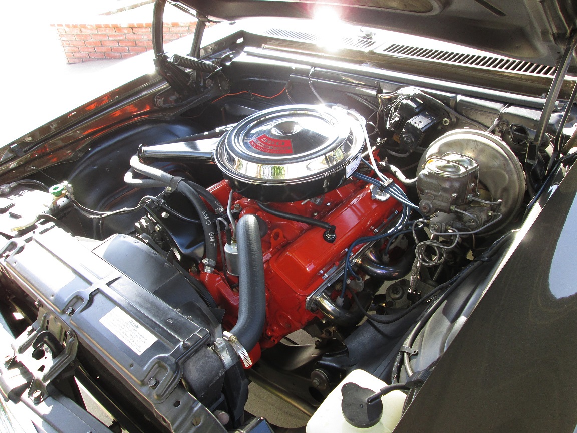

Being a BB guy my knowledge on the small block components is lacking [img]<<GRAEMLIN_URL>>/hmmm.gif[/img]
Need help clarifying what air cleaner came on the L48 with a 4spd...some folks tell me there was no heat tube, others say yes. I know one of you experts can help.
Photo below is like the unit I have with the chrome lid.

Wow! That's my old 70 SS Camaro 350! I have extra pics if anyone needs them.

Was it a 4 speed or auto?
The main questions seems to be about the heat pipe only be used on automatic cars and not on 4 speeds...can you add to this?
thanks..tom
*I found the photo online

The stove pipe (thermac) would have been used on all automatic 350.
The manual shift 350 cars received the AIR system (smog pump) and did not have the thermac system, so no stove pipe.
