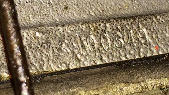

Here are Examples of Factory Stampings.
First is the Original Muncie , late build,
10 C &amp; 661 case with drain and fill.
69 Z/28. M 21.
the '777' vin stamp is Actually *111*

I understand the character substitutions mentioned (7 for a 1 in the one example, and I for a 1 in the other example). But shouldn't the substitutions of characters be same on block and trans if using the same stamp?

Yes, unless the engine or transmission was replaced as part of an in plant repair at AGR. Then another set of stamps could have been used along with alternate stamping locations.
