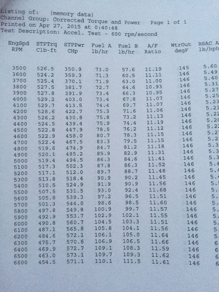

Default Two 427s
Engine 1.
Blue printed .060 over L72 427, 12.2 compression, 242/242 520/520 solid lifter cam, stamped LS-6 rocker arms, stock GM 840 rectangle port heads, 2.190/1.720 valves, factory 163 intake, 4 quart factory oil pan.
Engine 2.
.060 over 427 10.3 compression, 264/264 560/560 solid lifter cam, roller rockers, ported GM oval port 781 heads, 2.190/1.880 valves, Performer RPM air gap intake, 1 inch open spacer, Moroso oil pan.
Both engines will be tested with the same Holley carb, 2 inch headers with mufflers, which one will make more power?
