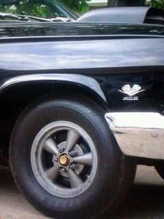

What's up guys, since I'm getting the 15x4 cragars they have currently have 5.50 moroso drag special tires. Obviously I can't run them in the street so I was wondering what was a popular tire you would run on a 15x4 back in the day? I see cooker has some. I'm guessing they would have to be a bias ply for the look. Also want the right size! Probably a 6.50-7.00? Any pics would be great! Thanks!

I just got some Firestone 7.10s for the front of my '69 W-31. They have the "ridges" on the outer edge and have the "look" I was seeking. I will change BACK to the other tires when I get back to the track---the 'Stones are very heavy. I have several sets of Cragars (various sizes, front and slicks) already mounted. The Firestones were readily available and weren't terribly expensive.

I have Moroso Drag Specials on the front of my car with no problems. I probably wouldn't put them on a daily driver but they're fine for a weekend car.

I'm with Mark as I too am running 7.10-15 Moroso Drag Specials on my Chevelle with 15X4 Cragar SS wheels. It's a little bit of a challenge but I love it and the look.
Technically the wheels aren't street legal along with the tires but I've never had an issue.
