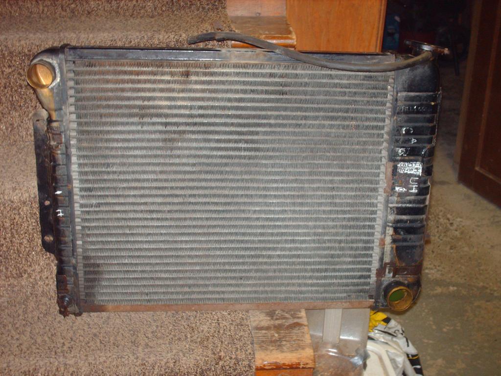

Looking for an original replacement for the radiator (CB) of my 69 Z28...or advice on having it re-cored or where to purchase a quality OE replacement. Is there anyone who just sells the core, without the tanks and top and bottom rails...the radiator repair shop nearby can solder it all together. Like to use the original tanks and rails.

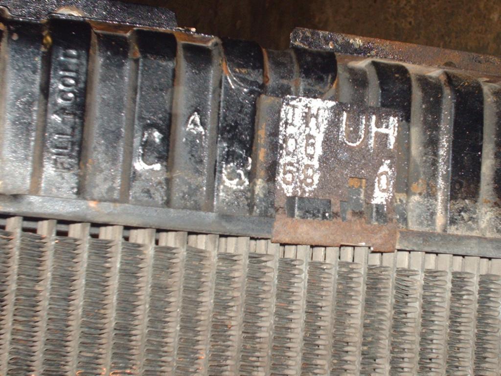

Make sure you remind the rad shop owner (don't deal with anyone but the owner) to keep the little tag, they are reproduced but not exact.
