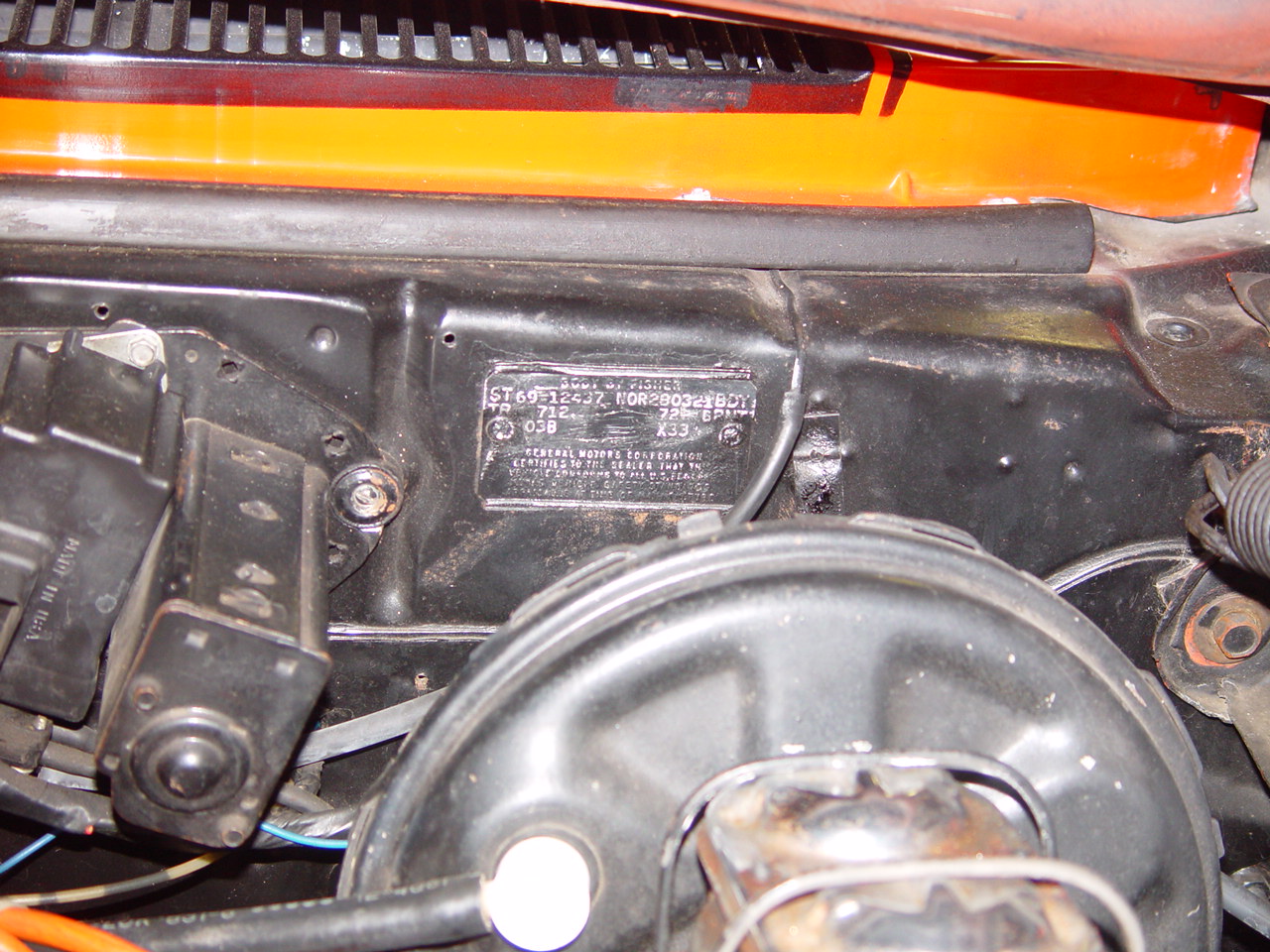

I have to ask about the stripes where they end in the cowl area because I have never seen an original paint 69 Z/28. I saw one picture of the area by the trim tag and I would have thought there would have been more over spray from the body color and the stripe on the firewall area.
  #12
Old 03-07-2014, 01:11 AM
x77-69z28's Avatar
Join Date: Apr 2008
Posts: 2,155
Thanks: 3,022
Default Re: 1969 H/O Z28 survivor
The cowl screen was painted off the car. Looks like there was some rattle can touch up by the cowl. There is black paint on the fender reinforcement which should be body color. Maybe when they painted the brake booster!

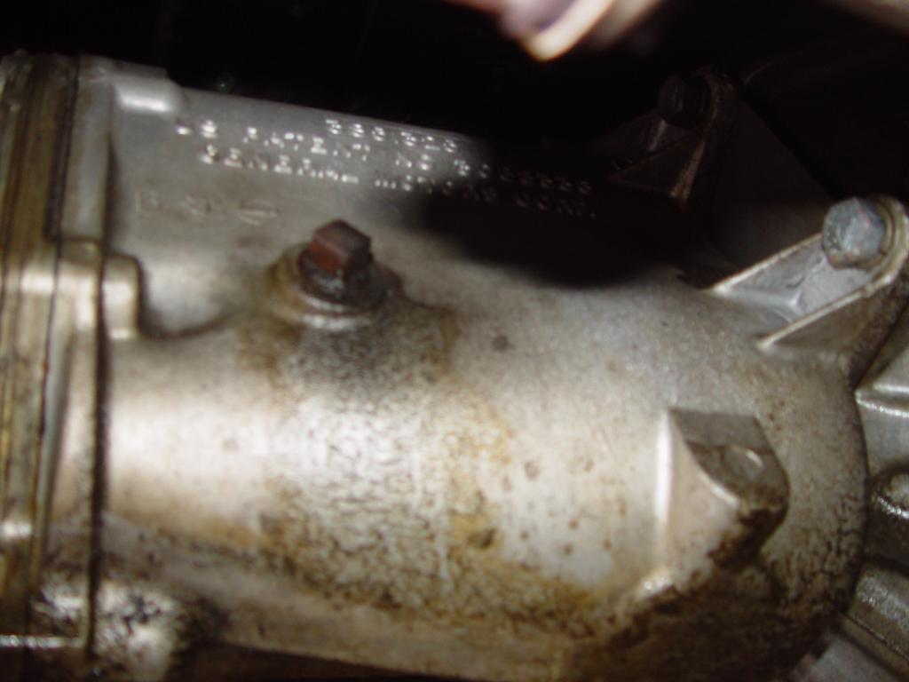

  #20
Old 03-07-2014, 05:56 PM
92646 92646 is offline
Join Date: Jun 2002
Location: Orange county Ca.
Posts: 1,407
Thanked 35 Times in 23 Posts
I got some pictures and I think the transmission might have been changed. I can not make it out 100% but to me it looks like casting 3851325 but I could be wrong.
