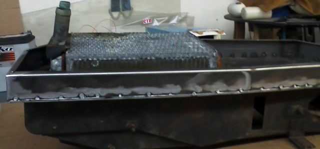

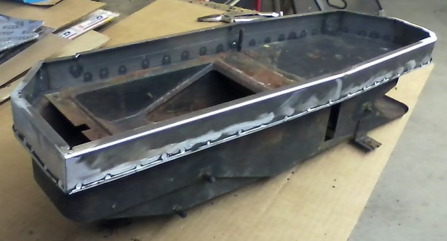

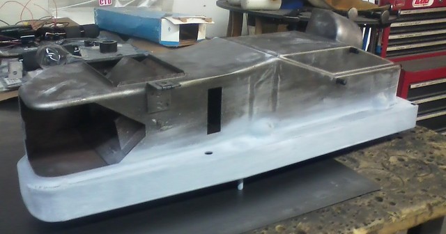

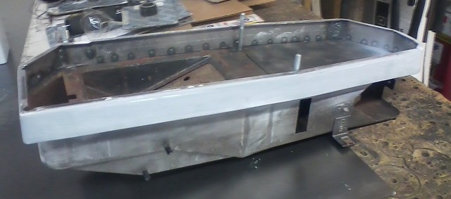

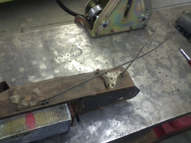

The outside heater box needed to be cut down quite a bit to clear the BBC. The problem with this is the heater core that mounts to the inner heater box, sticks out past the firewall 2 inches.
What I came up with is to move the inner heater box toward the inside of the car, so it will bring the core toward the inside of the car.
This was done by fabbing 18 gauge strips with a 90 degree lip and adding them to the inside box.
