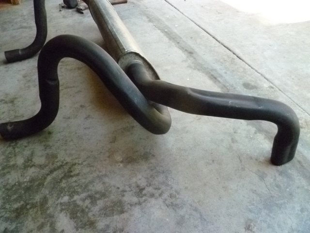

That is a '67-'68 LH tailpipe.
Looks to be painted aftermarket parts. Neither OE nor service GM exhaust was ever painted.
OE GM exhaust was made by suppliers such as Arvin, who also serviced the aftermarket. That is not a GM part number.
