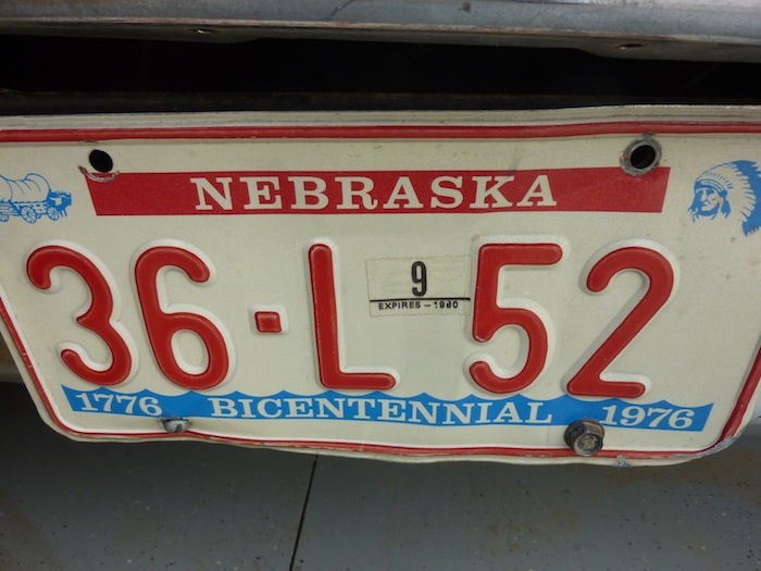

Here are some pics of the Nova.

A few more.

I like the 'A' '71' on the firewall, looks like another code is there too.
The single fuel line - and attaching clips - look original, (even has the non-safety rubber line clips), indicating an L78 version.

Was the frame removed at some point?? It seems bare metal??
And new upper control arms??
