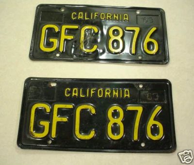

Found a guy on ebay selling the correct reflectorized month decals for California plates:
http://cgi.ebay.com/RED-DEC-california-l...=item53ddb426b1
So now I have the correct year and month expiration for the December, 1971 delivered car.

FYI Steve, I don't think CA went to the month decals (DEC) until the '80s. I think you want just the '72 decal and nothing on the other side if you want it to look as-delivered/new plates. Perhaps another CA veteran like Charley or ? can elaborate.

Anyone with California knowledge feel free to comment. I have seen some vintage photos of cars with the month sticker on the left side. Either way it covers the later &quot;73&quot; sticker that someone stuck there.

I can tell you for certain that the indetation for the month sticker has been on the plates since '63, and every original black plate I have had has had a month tag afixed to it. Not sure about the pre '63 yellow plates.
Did this car really come from Roseville up by Charley? I stay in Marysville all the time, and just had dinner in downtown Roseville a couple weeks ago, and I did not see or recall any GM dealer there. I wonder if it is still there.
You're car is flippin' awesome, BTW.

My 63 California plates had the depressions on both sides but came with no sticker on either side. I bought them new in 1963 and there was never any sticker on them. I brought the car back to Indiana late in 63 so I can't say what happened in 64.
