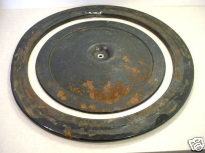

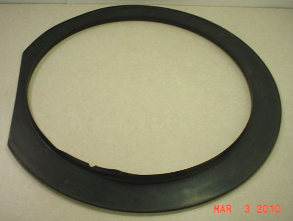

You'll need the flange, too. There are two out there. One with concentric OD and ID with one edge with a flat cut. The other one has a sort of egg shaped OD, and no flat. That's the more correct one.

Default Re: air cleaner for a 1969 L72 427
Here is a picture of an original Camaro flange and lid. Notice no flat cut off side, it is mostly round or oval shaped.
This style flange is now available as a reproduction.
Here is a Chevelle flange. Notice the flat side with the
sharp cut off.
This is what you <u>do not want</u> if you have a Camaro.
