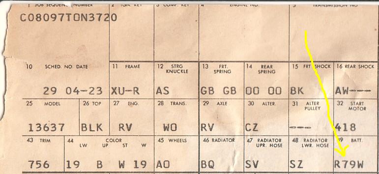

What would be the correct battery for an LS6 Chevelle built in early June of 1970 at the Baltimore Plant with the T-60 option. I do not have the Baltimore build sheet only the Canadian one. I know early cars came with a R79W. Was there a switch to the R89W later in the production and when ?
Thanks
Nick

R79W,and it wasn't just early assemblies,as the majority (99.9%) of them came with it.
The R-89W was the exception for a couple very late builds ONLY,(mid July 70-Aug.70),at some plants.
I few early LS-6 builds also received the R-59S top post,but they are by far the exception.

Interesting thread, so here's a question. My Bal LS6(12B) has an R79 ,but there was a sheet for smallblock elco found under the dynamat that was eight digits earlier, called for an R-59. Are there documented later built Bal LS6'S with R59's ?

R79W yours actually came with,and at least one did @ Balt. that I know of so far.
