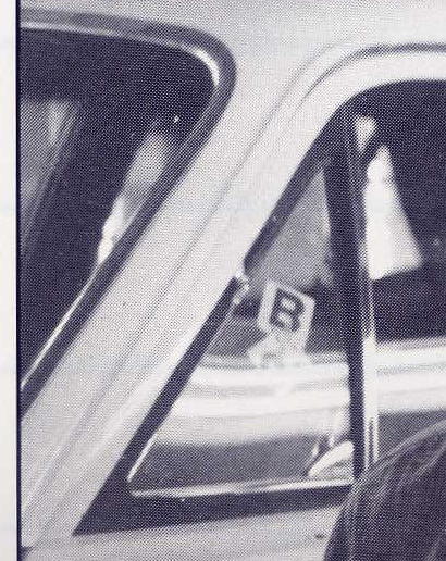

Default 1 of 6 L89 Nova? Opinions Appreciated.
Fleabay Link
Attachments - The Supercar Registry 402706-CopyofFile0009.jpg 402591-CBU373.jpg

This car has been beat to death, not only is the L89 questionable, but outside the 70 COPO Deuce cars, a CBW rear was not available in a 70 production Nova either, 3:55 (CBT)was the lowest production rear available in 70. Suprised it doesn't have an "original" tri-power set up on it. Where's the pic of the engine stamp.? POP.?

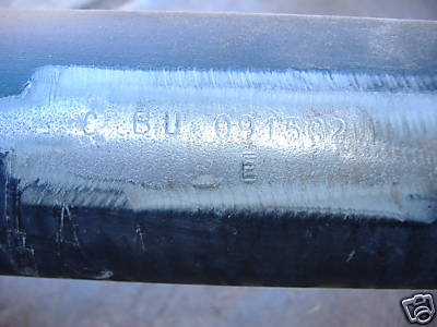

I have a June 1970 test in Super Stock and Drag Iluustrated on a L34 Nova that they state has a 3:73 twice in the article. I have to disagree with 3:55 as the lowest gear you could order. I have attached a pic of a "CBU" 12 bolt that looks legit also That only Novas would have as 69 Camaros did not use the "C" according to my 62-76 Chevrolet parts books. I feel the Silver Nova which was in the Dupont Registry a couple years ago is not legit. The homemade dual snorkel is a joke. I was also wondering about the Black one Legendary restored. Did they restore 2 Black ones an L78 and a L89? because I believe I have seen both. One with aluminum heads and one without. and 2 different POPs. Just my 2 cents.
