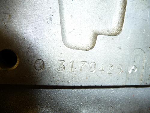

I have a set of aluminum ones going on my 67 Z and a set of iron ones somewhere. The alum ones have have 0 part # stamped in them though making them experimental.

Mine have bolt holes on the end of the heads but I don't remember if they have dates. They aren't here to check. Part # is stamped on the end of each head.
