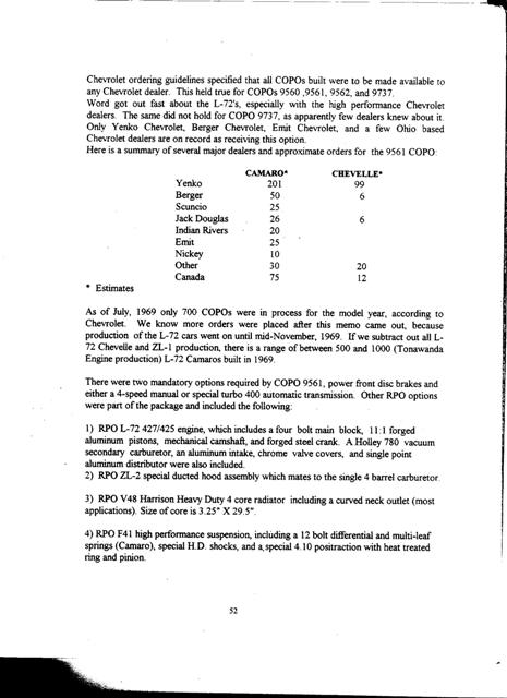

From the COPO Connection book, Shows a possible 10 sold so never say never.

Nickey...the largest dealer in America and a Hi-Po Kingpin could only muster 10 COPOs...but yes Jeff, I agree and I have learned to never say never! I would be curios to see what the the build date on that car is if it has that casting block...
That would be cool if one popped up!...you Chicago boys should chime in...

The car is a fraud and so is all the paperwork presented to prove its Nickey and or COPO 9561 Status, let's not give this thread and this bogus car anymore publicity.
There are currently no found Nickey 9561 L72s in the Nickey Registry.
