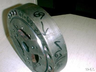

Well here is one that I have that matches the description (I think). Tell me what you guys think. It is 8" and dated L8 on the backside.

Does the key ways line up?

The key ways do line up.

Probably an L79 balancer and or a 1967-68 Z/28 balancer. In 1969 the key ways were offset. The timing chain covers were different also between the years.
