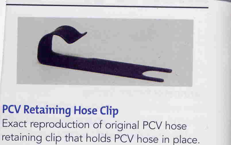

If you find a person who can make these pcv hose clips Gm part # 3972132 I would like to purchase a couple myself. I have a 1970 Nova assembly manual that shows the date these clips began use 1-25-70 on the L78. In the NA9 section it shows Novas using a single clip for a SBC on the front of the air cleaner with the same part #. I could not find these clips or anyone who made them so I used (2) repro 69 style pcv holders that attach to front right side carb stud with a vise and careful bending and dremmel grinding made some nice alternative ones that work fine and look correct until someone comes out with them. My manual shows the Hockey stick style smog tubes also.

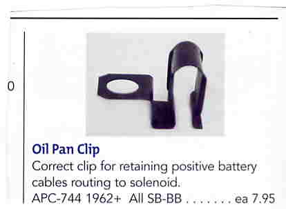

Here is another alternative.

Very good Idea.
Where can I order that Battery clip in your second picture?
