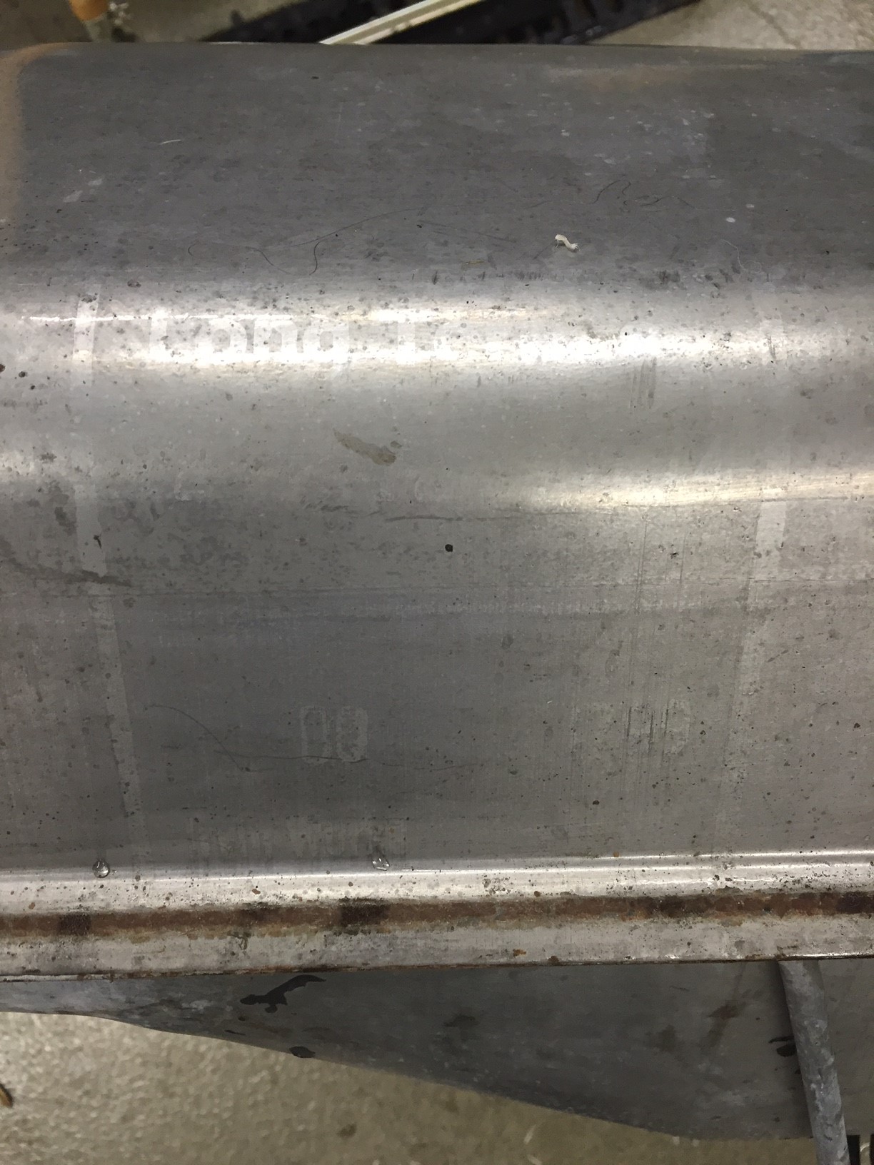

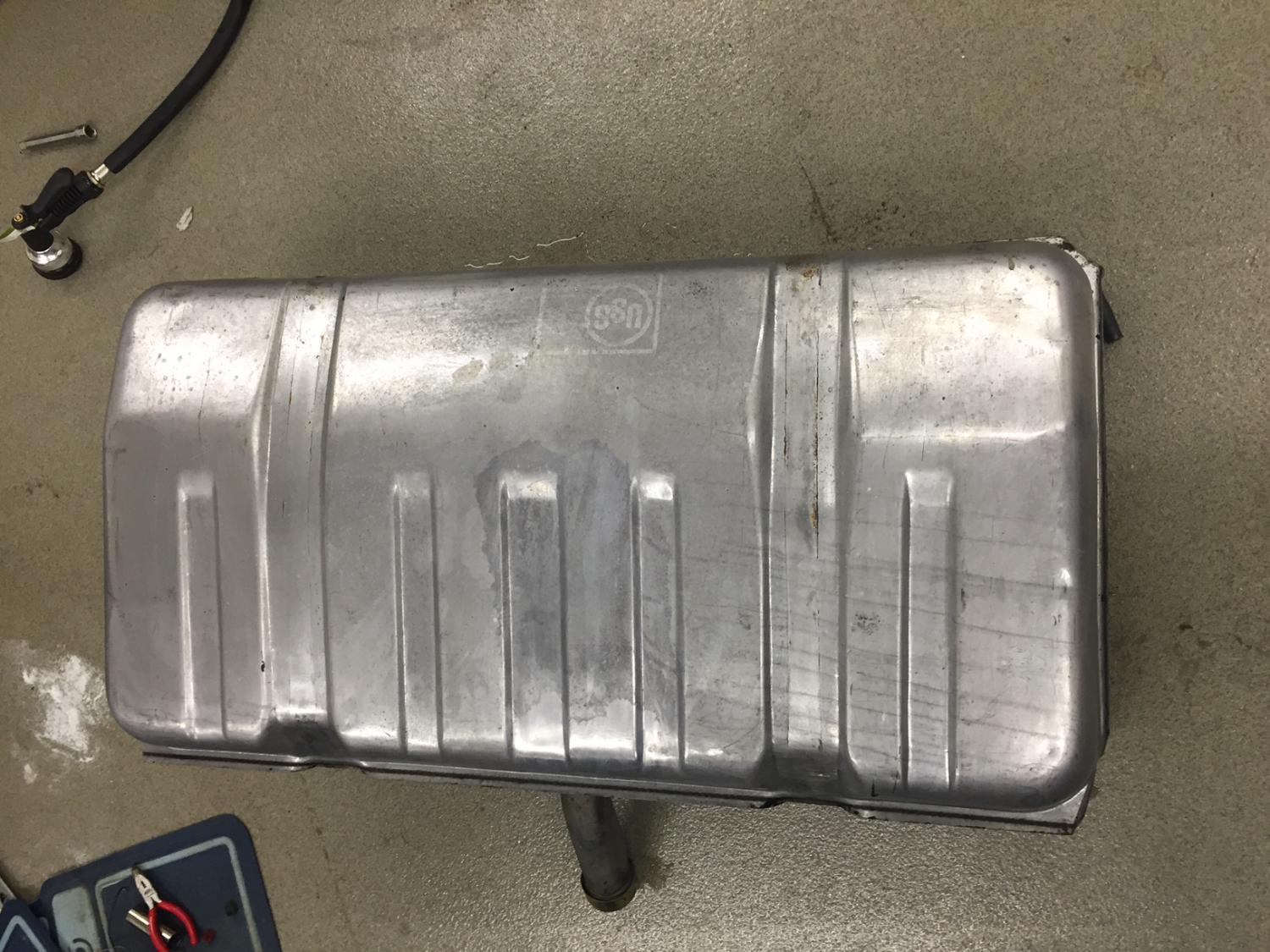

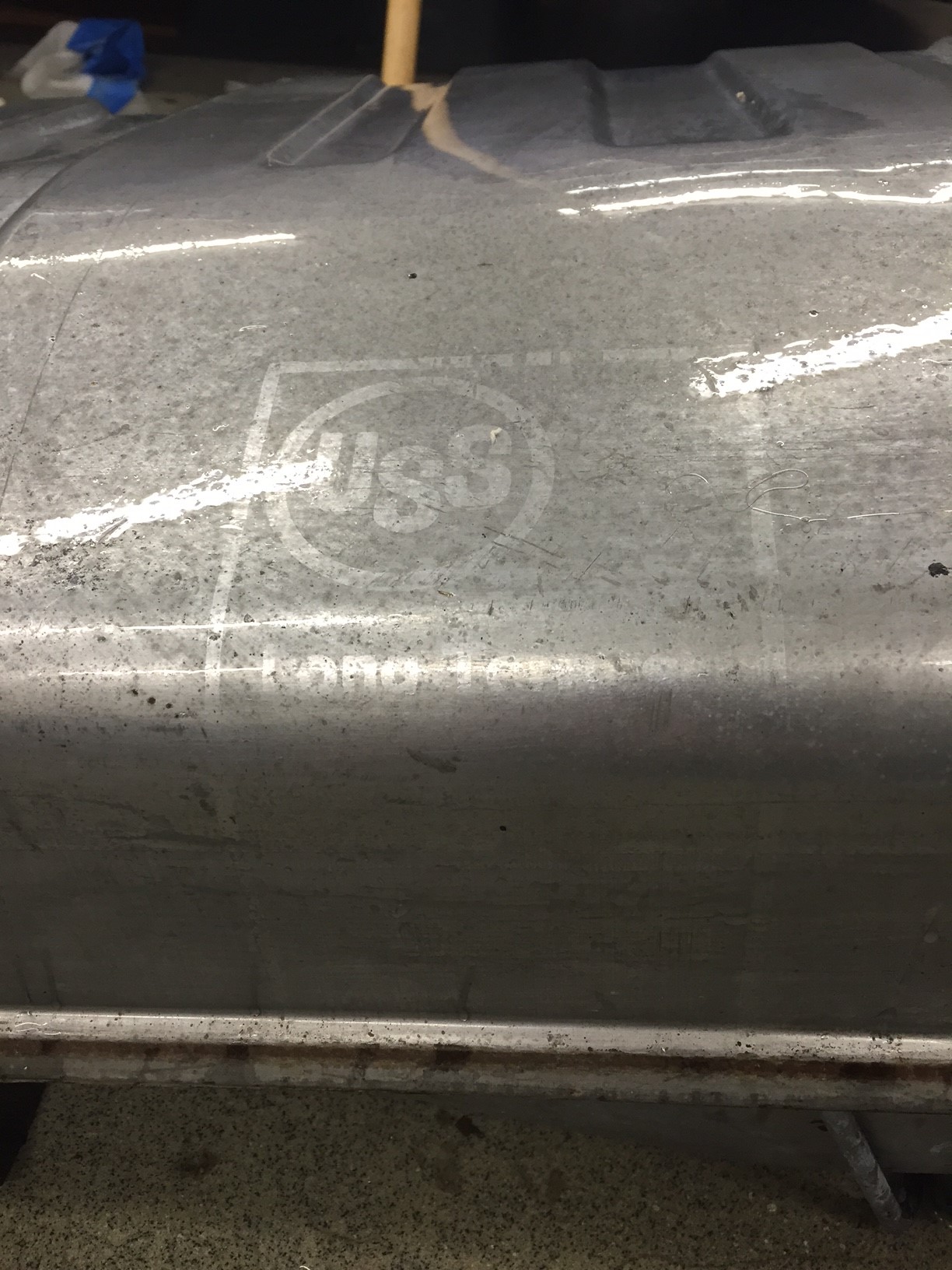

I am looking to see what some of you have done or suggest to remove some paint from where is does not belong.
On an original car I have, there is some spray bomb "fluffing" that had been done on a few areas of the car (chassis components, shocks, etc). I believe there to be nice original finishes underneath.
In advance.......thanks!
Tim
Attachments - The Supercar Registry 74z USS tank stamping lower.JPG 74z tank USS tank stamping upper.JPG 74z gas tank.jpg

On my 1974 low mile Z the previous owner went nuts with black spray bomb on the floorboards and gas tank. The gas tank was spray bombed black, then pin striped
I read where oven cleaner would remove spray bomb paint so I tried it on the tank where you couldnt see it. I sprayed it and let it sit and then basically washed off the paint.
I ended up doing the whole tank. Results were amazing as it looked like a brand new tank.
I could even see the factory USS stencil marking on the tank.
Here are pics after I did this.
