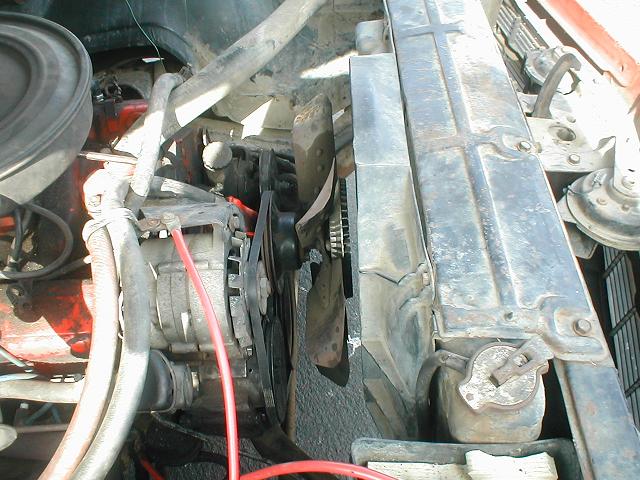

At the MCACN show in Chicago, I lost 2 points for my power steering reservoir cap. It's the metal cap with the ears, not the round plastic one. The judge looking at the motor said it was the only thing he found wrong under the hood. I was really surprised because that was something I was sure, was correct. Now I'm not sure. He kept saying it should have a black cap, and I thought he meant the round cap like the 70's have. So I started looking for a 69 survivor with power steering and couldn't find one. Question: What should a 69 L78 Chevelle power steering cap look like. Round, metal with ears, natural/nickle plated, or metal painted black?

Bill, my understanding is that sometime in the 69 model year the cap was changed from the metal, ear type to the round plastic style. Not sure when or why this transition took place. Either is correct and I have seen both styles on 69 cars.
The metal cap w/ears should be painted black in color. I have an original/used one that I recently found which you can see remnants of the black paint on it. I'm sure lots of these caps lost their paint due to handling and fluid being spilled on them over the years.

I just found this in my archives, this is a low mile unrestored 69 SS. Looks like the cap has about as much paint as Rick's 6 banger.

Bill this is the cap that was on the power steering pump when I shipped the car (notice the deep groove pulley).

We restore all 1969 Chevelle`s / El Camino`s with the cap left natural, no paint. I agree... it just make the engine compartment look much nicer. If your worried about future judges at future judged shows, than have two power steering caps. One painted for judged shows and the other natural.
