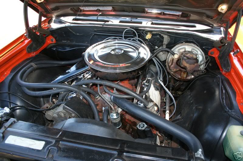

92646 12-01-2009 07:57 PM
Re: Power steering cap detail
1 Attachment(s)
Bill this is the cap that was on the power steering pump when I shipped the car (notice the deep groove pulley).
