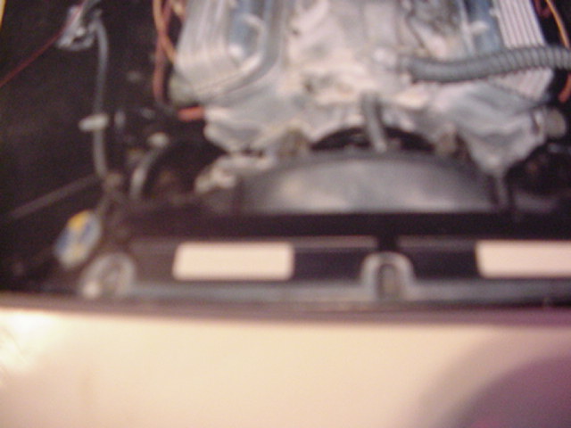

I've hit a wall with the fan shroud on my '70 Z28 . I ordered two from Classic and they both had Caution Fan stamped on them , then drove over to NPD yesterday and the same problem, Caution Fan stamped into the plastic . The original shroud doesn't have it and all the pictures I see of these restored 2nd gen Camaro's don't have that crap ,so who knows where I can get the correct fan shroud for a '70 Z28 Camaro? Thanks and be safe. Happy New Year!

Good Luck, It's a super hard piece to find, you see the standard one every now and then but the large one you need is tough. All the GM one's now have the Caution fan on them you won't find the correct one in a catalog.

Rick Thanks for the pictures. The 2nd top plate in your pictures is the same as mine Has the same #s I also went out to garage and has a L in front of the part #. The two shrouds you show are different than mine the narrower shroud has ribs on it going across the shroud mine if you look at the org. picture has two ribs going the other way.

Rick, I just scanned that same picture. This one is alot clearer.

That shroud in your picture is the same shroud used on the big block. Very rare. If you still have it I would save it and get the 2 piece shroud for the Z/28. That is if you are using a SB.
The BB and VO1 option used the same top panel.
