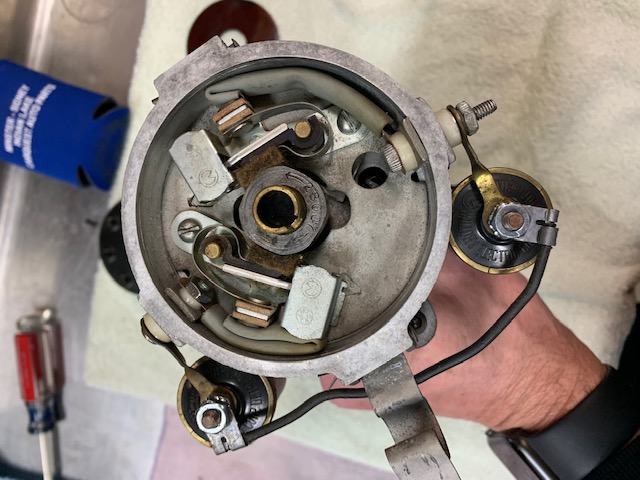

I've accumulated this group of parts with the intention of putting it on my COPO. I want to confirm if these parts all work together (I think they do), and if anyone has a wiring schematic so I know I'm hooking everything up ok. Any tips/advice/thoughts?

You will need a rev Pol distributor to be technically correct but it appears they setup that 310 to potentially work as a rev. The YC310 is the standard distributor. I have a rev Pol distributor in the garage that I need to restore.

Thanks for the link Darrell. Are you referring to the jumper wire between the two condensers as the modification to make it work like a Rev Pol? The SuperMag transformer has another terminal under that red cap, is that used when you need a double coil?

Condensers are separate on rev. Cam plates are also a little different but again you can run that distributor with rewiring. norcam is correct you need a rev Pol coil. Super mag is for a magneto. I have a couple coils but not worth using.
