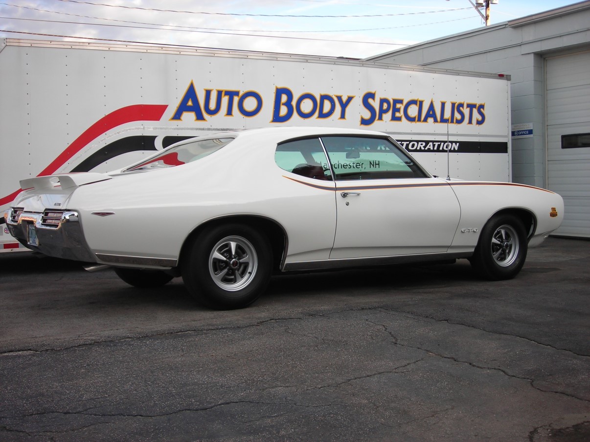

I have been using Hotchkis 2" and 3" drop springs to get a nice ride height. This Judge has a 2"drop spring.
Jay.
