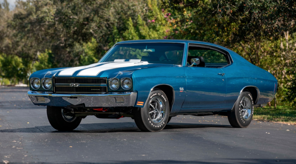

Lee Stewart 03-02-2021 05:35 PM
1970 Chevelle LS6
https://i.postimg.cc/y8m05YR3/screenshot-8563.png
https://www.mecum.com/lots/SC0521-46...-chevelle-ls6/
olredalert 03-03-2021 03:05 PM
----To the next owner, please lower that car......Bill S
SS427 03-03-2021 04:13 PM
I would love to know what exact springs people are using to get them to sit correctly. As of late we have had nothing but trouble getting these cars to sit down where people like to see them. I have 4 cars in the shop and all 4 sit at this height. ALL have original assembly line springs in them on all 4 corners. Two of them still had the tags on them when they came in as well as original assembly line shocks but sit high. I have tried several different Moog springs and am now onto trying Eaton springs. We have also done all the math with the vendors to try and resolve it and have a TON of money in both labor and spring cost and have not been able to get them to sit right. Been doing this for 40 plus years and these last 4 cars are killing me.
