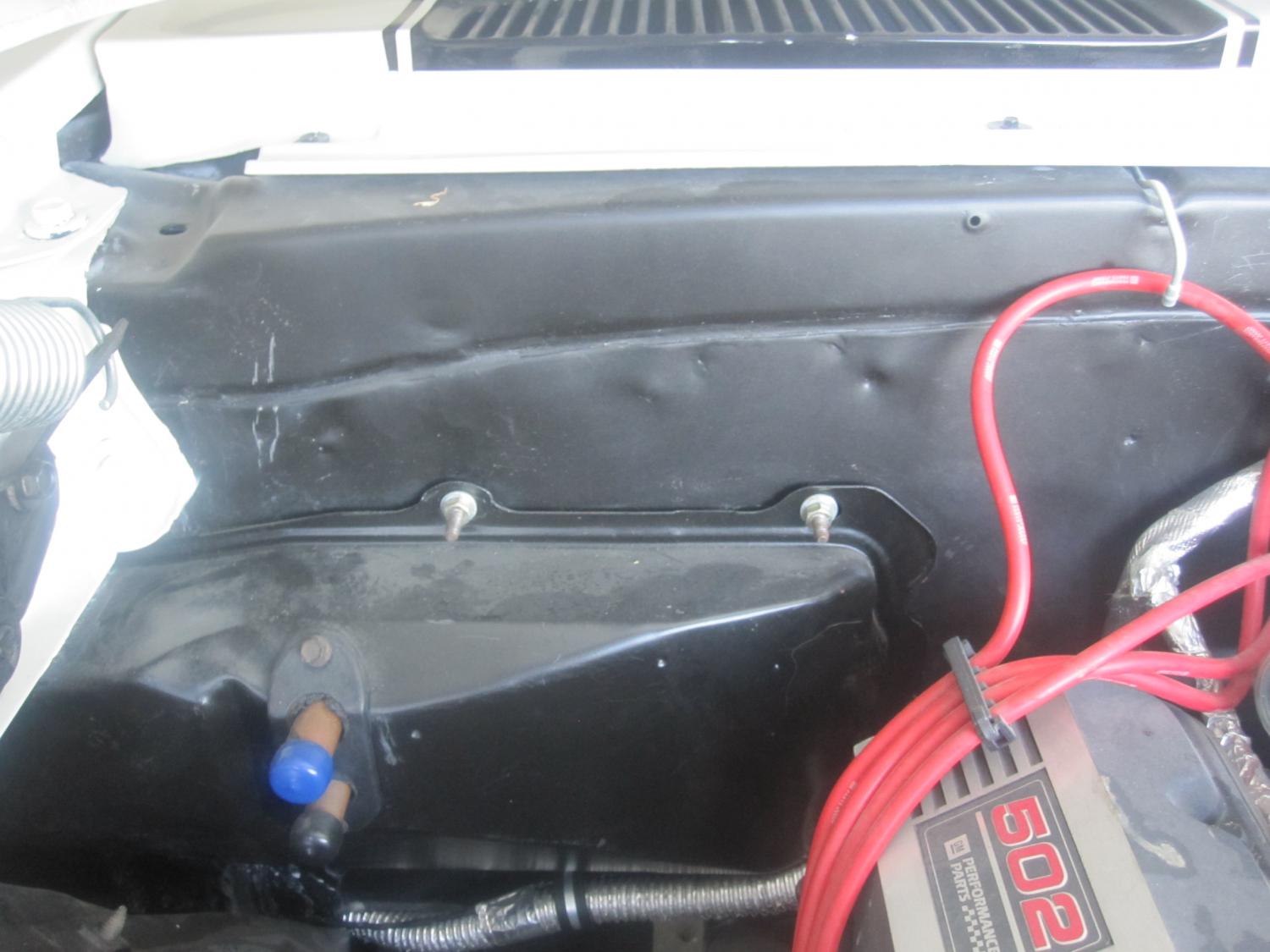

I have a 69 Camaro what is the best way to get some information on it such as what engine, transmission rear end it was built with.
the vin#124379N618601

Post a picture of the car, engine compartment and trim tag on the firewall. That will be a good start.

Here is what I can make out on the trim tag
St69 12437 NOR 245647 bdy
TR ? 711? 50 ? 50 PNT
03d x44

It was nice talking with you on the phone the other day. It sounds like an interesting car. You may want to give users here a little more background on what you know about the car. You mentioned you acquired the car in the early 70s from a racer who was given the car by Chevrolet. You also mentioned the car was known to have left the factory with a 427 engine. A NCRS dealer report would likely help support this if the car shows as delivered to a zone office rather than a dealer. There is a link at the top of this page to order the NCRS dealer report.

I don't see a hole where a cowl induction relay would have been on the firewall for a 427 car. Heater box has been off.

This hole , location can vary slightly from car to car.
