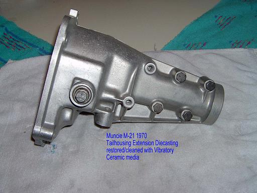

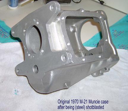

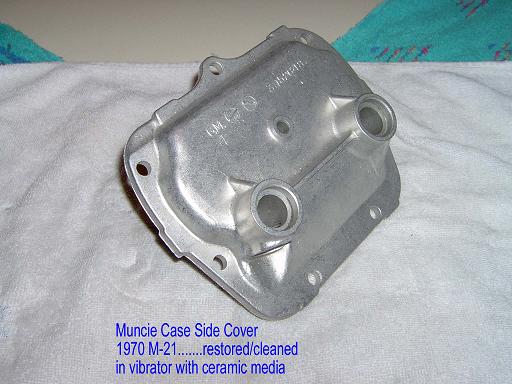

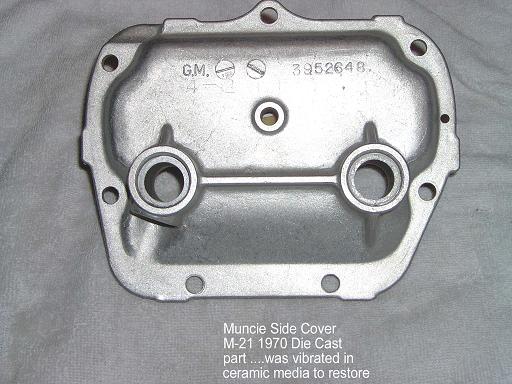

The die cast pcs were run thru a Vibratory shaker machine...........
The sand cast case was shot blasted with fine steel shot in Wheelbrator machine
Fasteners were manganese phosphate plated and then sprayed with Fluid Film

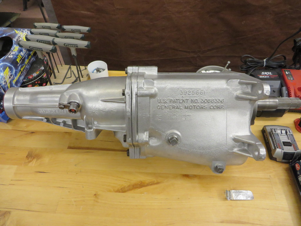

Those pieces came out nice Chuck. I like the factory sheen.
Have you done any valve covers yet?

I can make anyone's Muncie case look like this, PM for details.
