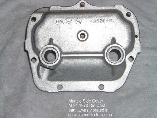

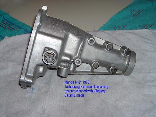

The die cast pcs were run thru a Vibratory shaker machine...........
The sand cast case was shot blasted with fine steel shot in Wheelbrator machine
Fasteners were manganese phosphate plated and then sprayed with Fluid Film

Those pieces came out nice Chuck. I like the factory sheen.
