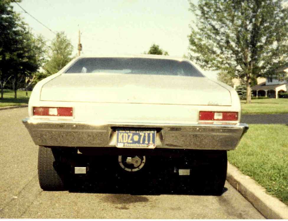

Am trying to dteremine what is the correct number of leafs in the rear springs of a 1969 369/375 Nova. 4-5-? Also, once determined, will need a good original set. Thanks; Tom

The Novas used the 5 leaf rear springs with 'concealed' anti-squeak pad pockets. They are not too hard to find, but decent sets will cost around $200+ and then might still need to be re-arched. I understand that Ron Norman is selling very nice repros if you'd like to investigate that option.
You will also need the non-F41 lower spring brackets, only the F41 version is currently available from GM. The F41's can be used, but you would have to hack or burn off the sway bar extension.
