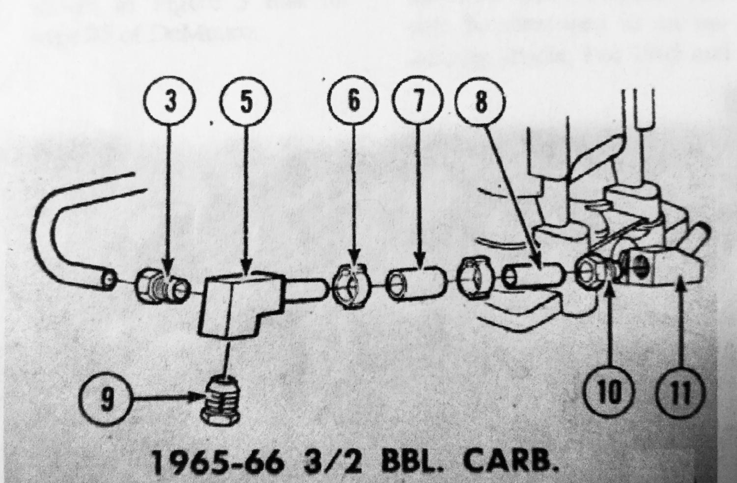

Interesting there is no hose going to the hollow carb mounting stud on the pass side front of the rear carb.Just has a rubber cap on it?Tom

tjs44,
The test car and my car have the flat top cap on the hollow stud as these cars do not have air condition.
Air condition cars with Tri-Power pulled their vacuum source from that hollow stud on either the rear carb or center carb as shown in the illustrations.
Thanks, Chris.

Follow-up on tjs44 above question.
This 1966 GTO sold through Hemmings about 9 months ago and offers a good photo of the air condition vacuum hose coming off the hollow carb mounting stud.
You can still see the end of hose marked with dark blue paint just as the shop manual illustration shows.

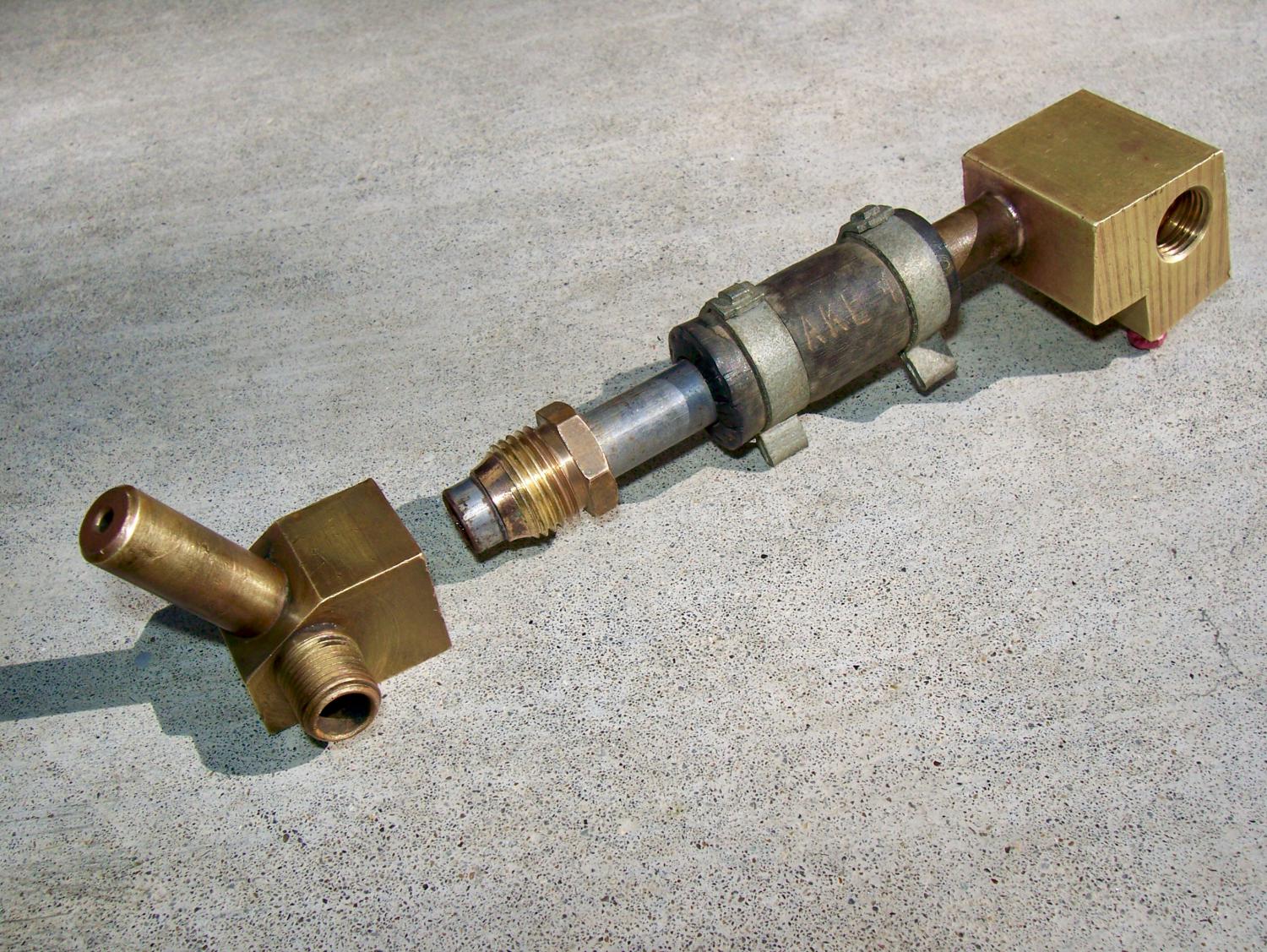

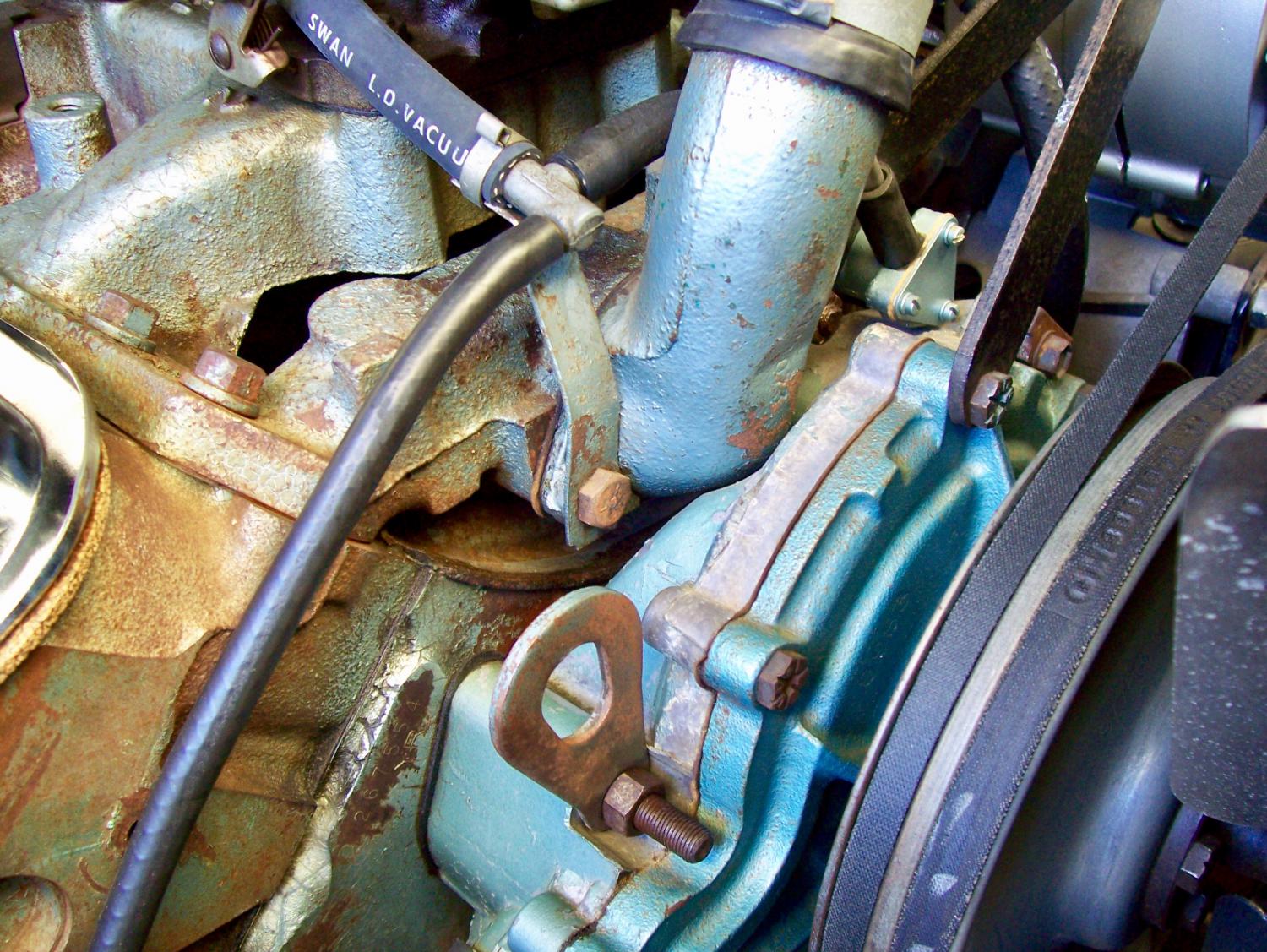

Right Side.
Where would we be without Vacuum.
Brass fittings, steel pipe, crush clamps are what comes off the front carb throttle plate and provides Vacuum for the Power Brake booster, Automatic transmission module and the Vacuum reserve tank.
After this busy intersection comes a check valve leading down to a cast T fitting clamped in place.
One long hose goes to the Vacuum reserve tank mounted up front of the fender skirt.
The other, shorter hose goes to the thermostatic Vacuum control assy.
The purpose of this unit was to disable secondary throttle activation until the engine reached operating temperature (165 degrees).
