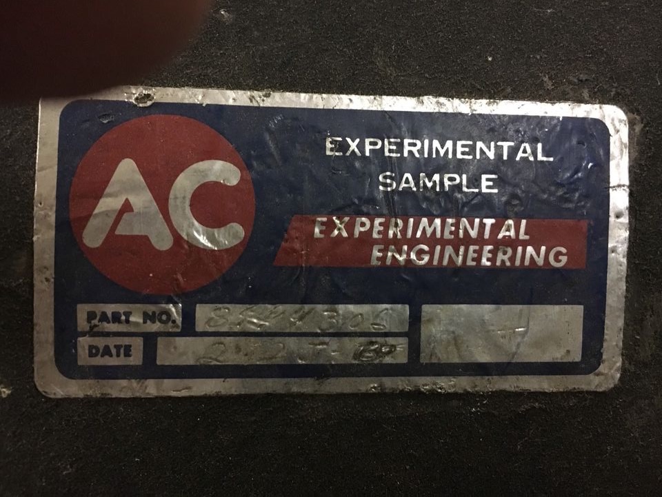

Need some help here, a guy wants to sell me this part, and frankly I am not quite sure what to make of this thing.
Thanks in advance.

Cool. What does the top side look like ?

That must be the piece that was on Kijiji Ontario a few weeks back, someone here posted a link but when I tried, ad had been deleted and only a tiny picture of the decal still showing.
Are these AC Experimental Engineering decals known and what is the year noted?
Whoever has it now, have they tried to see how it lines up w/ cowl area etc when in position to suit cross rams?

It surely looks like some kind of a air intake plenum. But what it's for is a big question.

I just got the remaining photos, and to me this is a no brainer. Yes the Air cleaner is in Canada.
Here is what I think:
Crossfire prototype
The Tag has been monkeyed with.

Date on the tag was likely 79 to begin with
That is what I had a problem with figuring it out. I was thinking crossfire injection. But the questionable date wasn't helpful.

It was for sale for $1500 last time.
Be VERY cautious, that steel/foil sticker has definitely been tampered with.
