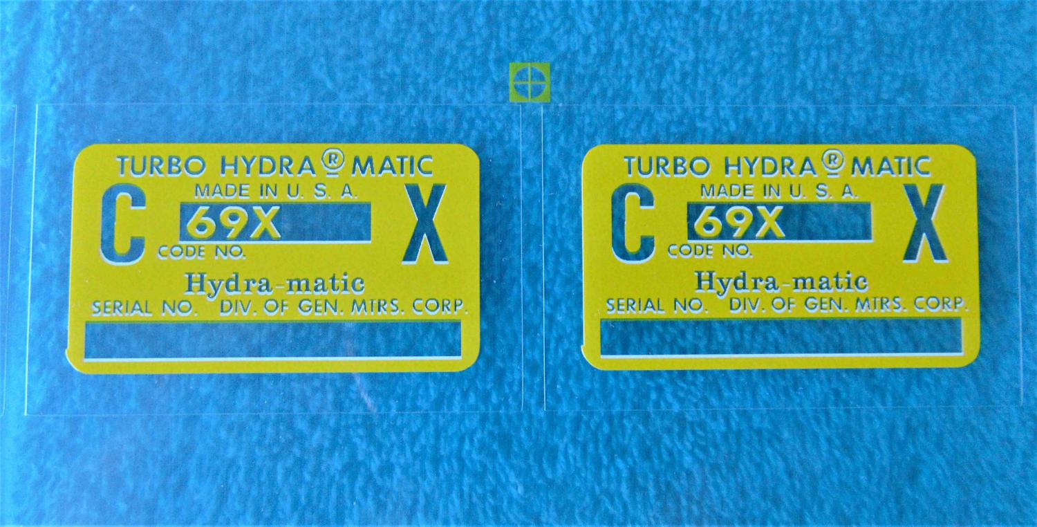

I have made a decal to restore the trans ID tag. The stamps used to impress the #s are very very hard to find with the correct font.

Said decal.
