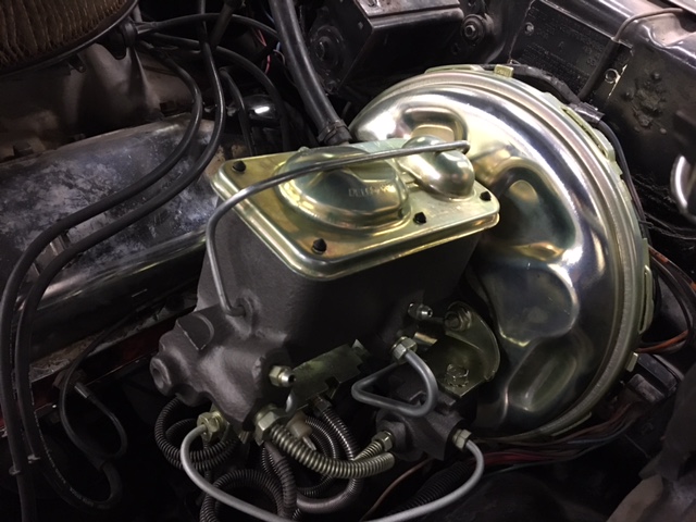

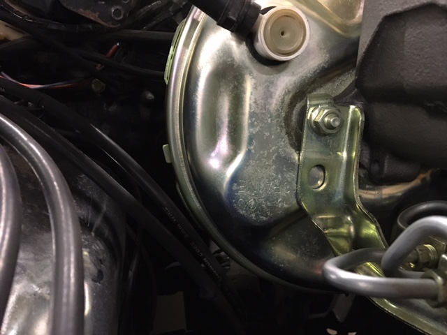

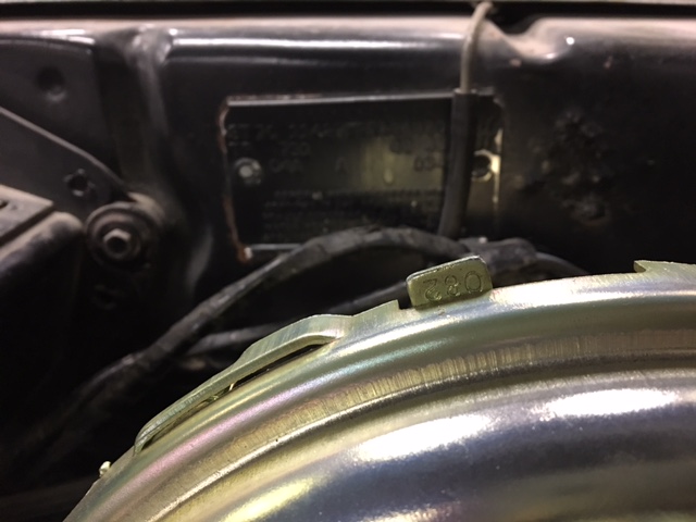

From my 70 L78 Nova
DM upside down
082
Gary
