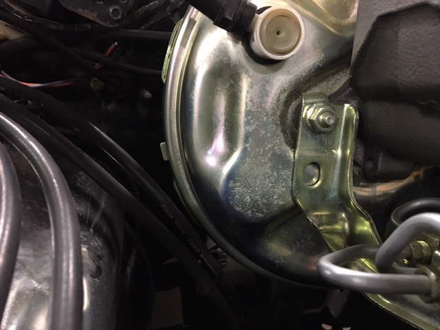

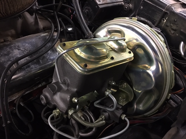

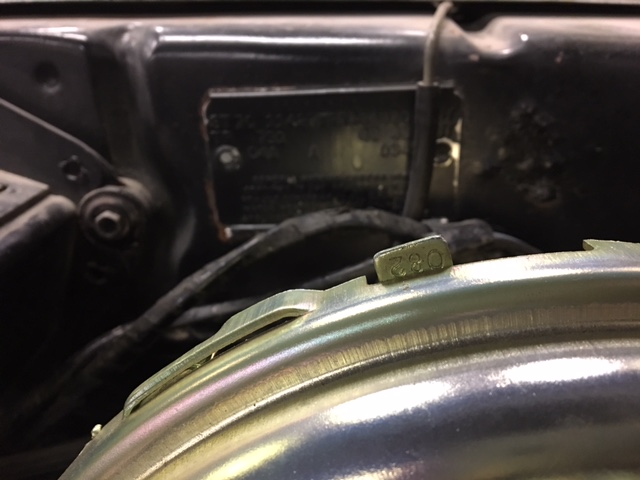

L78_Nova 10-23-2017 02:41 AM
3 Attachment(s)
Attachment 101887
Attachment 101888
Attachment 101889
From my 70 L78 Nova
DM upside down
082
Gary
