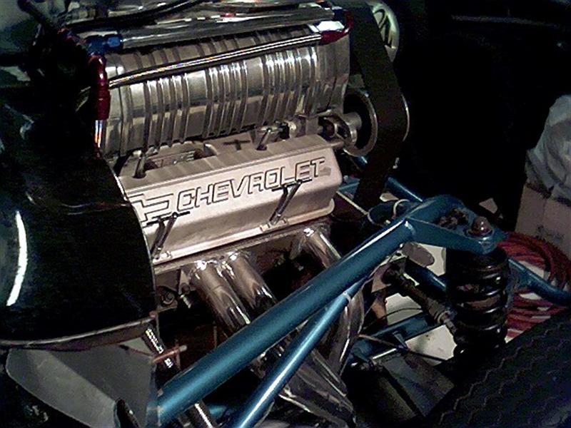

Shopping for headers for my Malibu project. ANyone have any experience with these Hooker numbers??..recomendations??
2217 Super Comp and 2455 Comp..both are 2 in wiht 3.5 collectors..any advantages with the "tuned" headers over the non tuned headers??..other than the price . Motor is a 11:00.1 open chamber ZL-1 with a mild solid roller. Thanks

Don't tuned headers have equal length tubes...making for more consistent power?

Super Comps are good headers. I like the 3" collectors. Gives a little more room to work. Try to get as tuned as you can. Does not mean as much in power terms with the full exhaust on and all corked up, but you are only going to buy these tubes once so go ahead with the better headers. I have Supercomps on my Z/28 and they never leak or show any signs of cracking/warping problems. JMO Sam

al, here are a couple pictures of my 2 1/4 in super comps. these are very close to equal length but one tube goes outside the frame rail on both sides.
